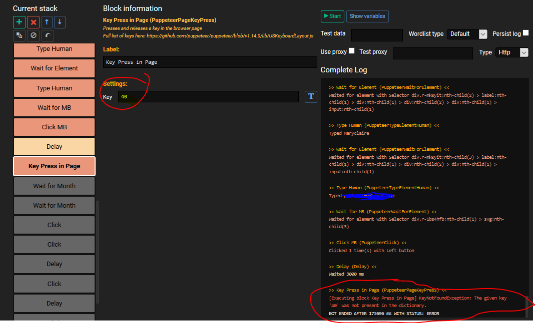

How to use Key Press in OB2
I put the number of the key from github I want to use but probably it’s not the right way to do it!
You have to put the name of the key in letters, not the number. Instead of 40 you need to type Numpad2.
